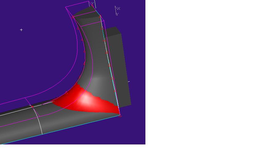

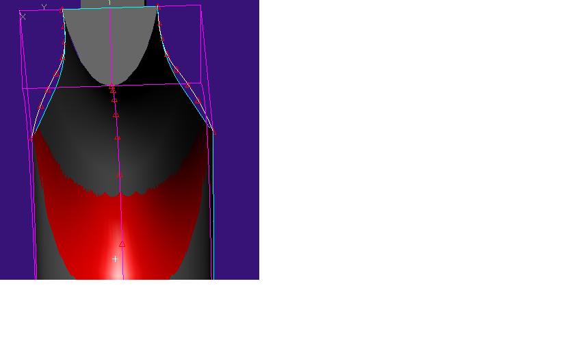

I've been playing with necks some in VX. Here's a couple of screen shots of where I'm at now with it.
Getting the surfaces to follow the curves and be tangent everywhere has been somewhat of a challenge.

A lolly pop cutter would of course work but it seems to me it'd have to be pretty long, maybe not as bad as I think. Are those available with out going to custom cutter?
It maybe easier as Parser shows in his tutorial and just get the major surface and touch it up later.
Then again it really doesn't take all that long to hand shape a neck does it.
Any thoughts are welcome.

I'm not familiar with VX, but in SolidWorks, Rhino, and all the other packages I've used getting tangent/curvature continuous surfaces is dependant on setting up tangent/curvature continuous guide curves.
That model that you have in your screenshots is very similar to the level that I complete mine to with Rhino.

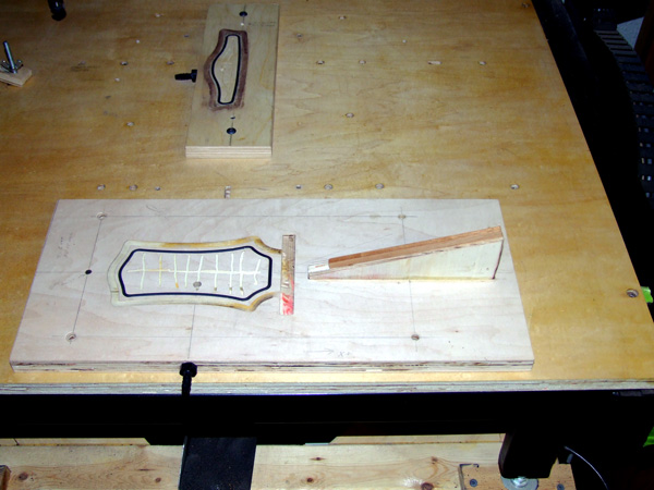

Here's a sample of a couple of fixtures on my machine (which is not very nice but it works, sort of).
I drill locating pin holes in the table along with some taped holes to hold the fixture down, much like Rick is doing. I write down the coordinates of my set point relative to the home position on the fixture. This way I just put the fixture in the same pin location every time , move the machine to the coordinates, g54 it and I'm ready to go.
If I had a Fadal type machine I'd mount and Aluminum tooling plate to the bed, cut it flat and place my bushings in the plate and just let live there. That is if it was a pretty dedicated machine. I believe this is waht Taylor does, only with out the aluminum tooling plate.
The fixture in the front holds the head stock down to cut my peg head shape. The neck registers in the truss rod sloton a 1/4 spline on the angled riser.
